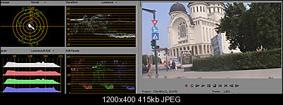

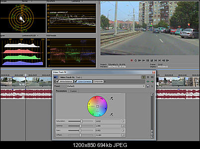

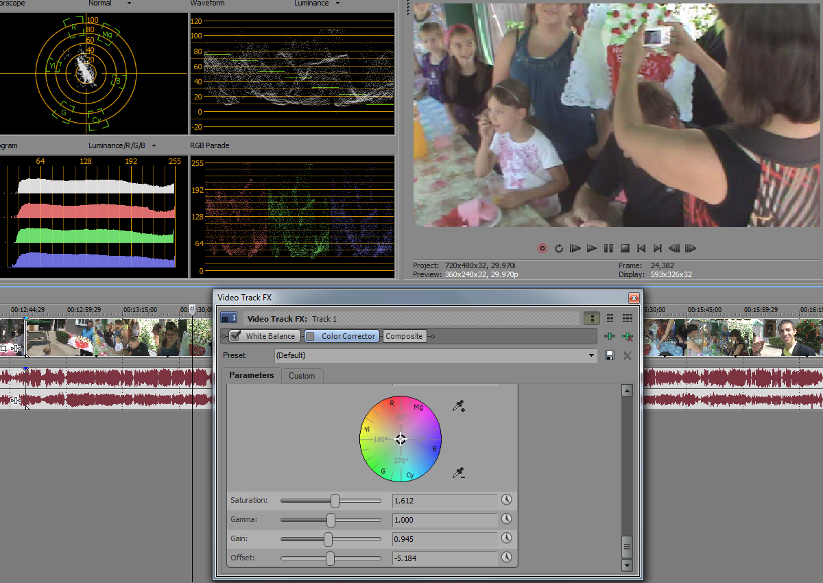

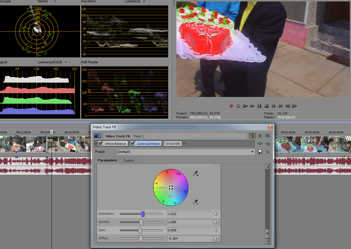

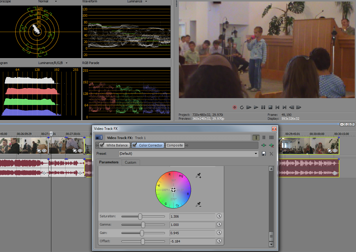

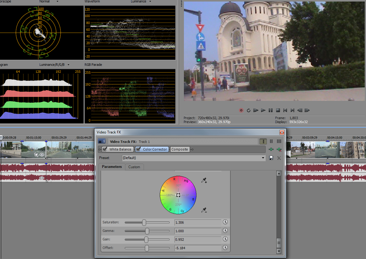

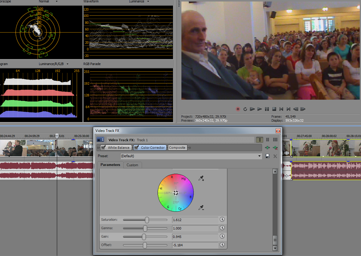

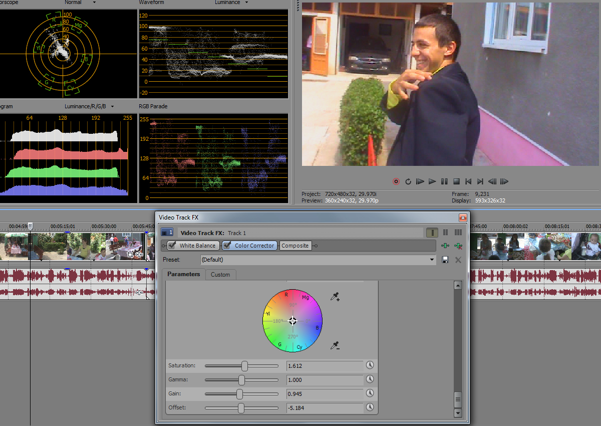

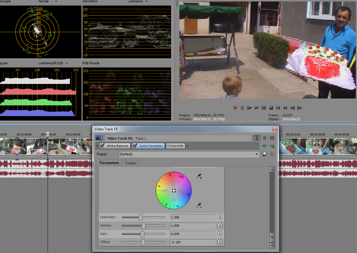

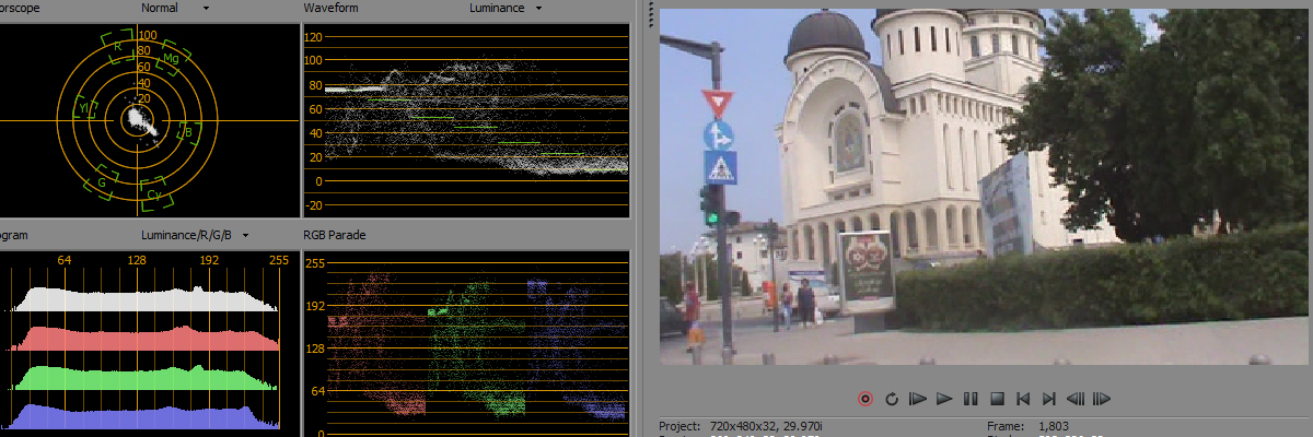

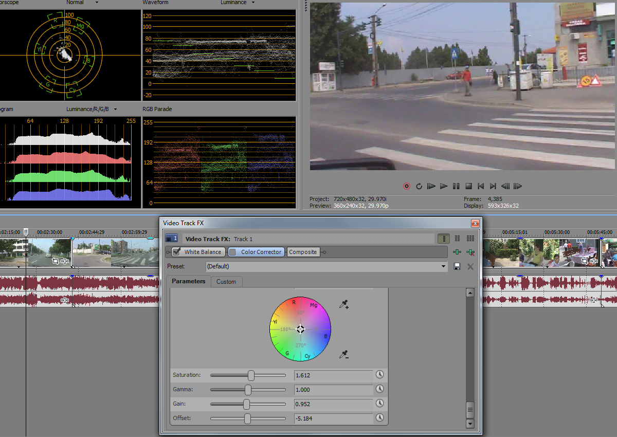

  1. First off, this is a long post filled with many examples, you can see how much I care in getting this right. If you know what you're doing regarding this and feel like you know what's what in this field, I appreciate you taking the time to go through all of this.
    I know the general idea is that personal preference is the answer, but as a novice I still don't really know how much is too much, even by looking at the graphs (vectorscope, histogram, etc) as I don't know everything about them. These videos were recorded with a camcorder 6 years ago, I'm combining and color correcting them in Vegas before frameserving out to avisynth for QTGMC and ccd.vdf.
    Before I show you some examples for guidance, note that I have already set a white balance on the project.
    Regular:
    White Balance:

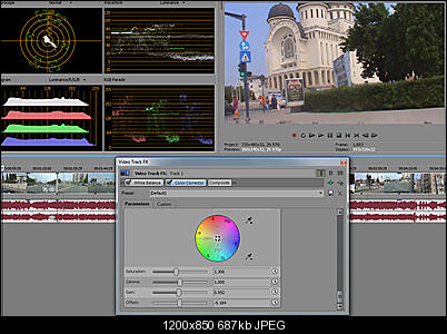

    Now here it is with color corrector and a saturation of 1.306:

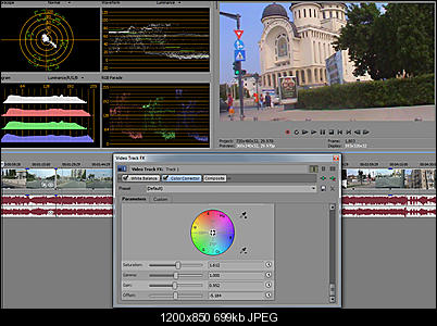

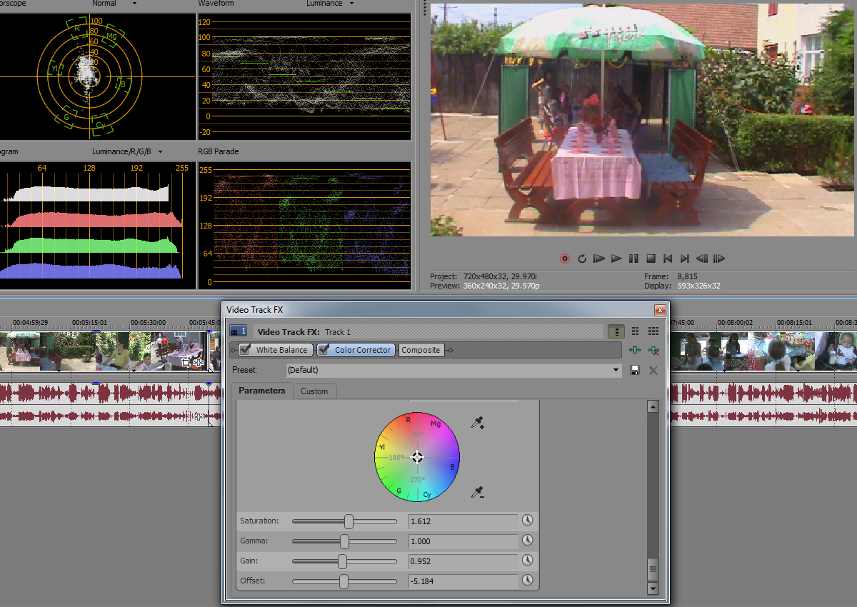

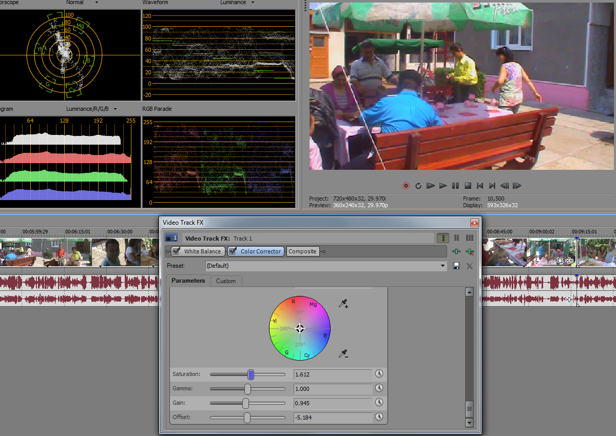

    And my preference for the sake of this thread, 1.612:

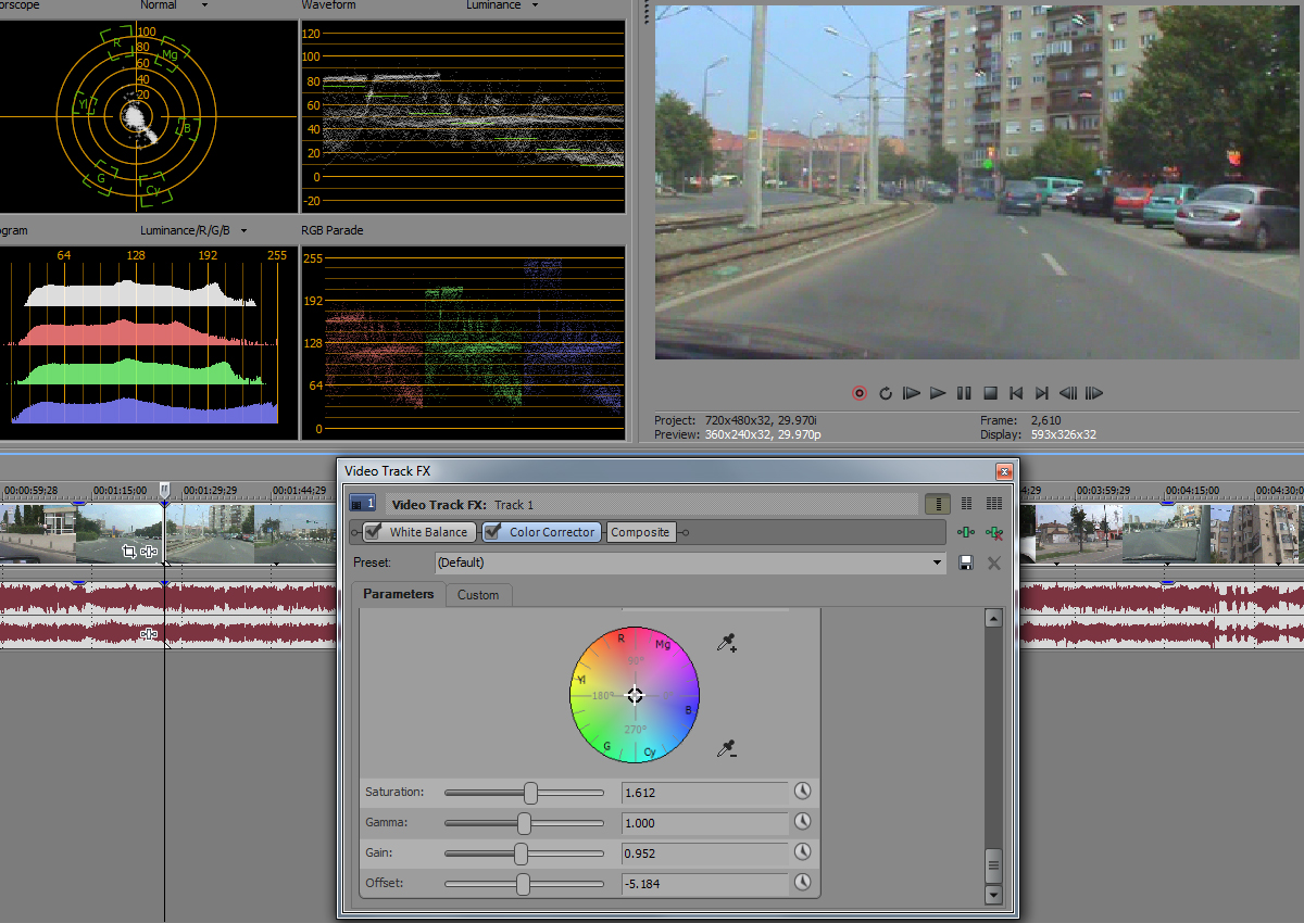

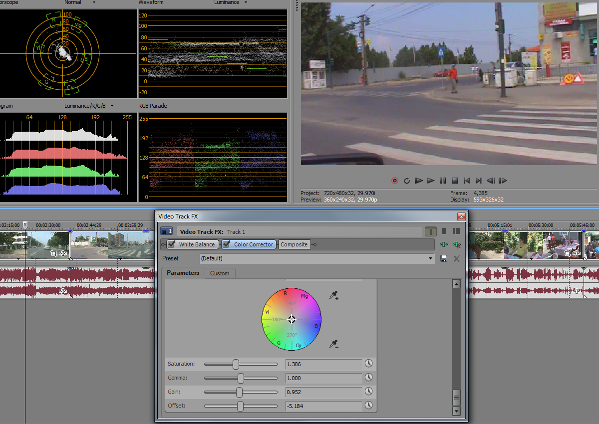

    So in these next set of examples you will see the comparison between the regular footage (with white balance obviously), midway through my preferred saturation level, and then my preferred one.

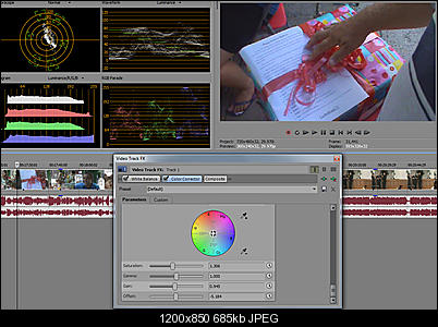

    1.306

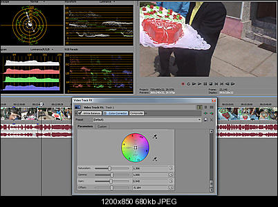

    1.306

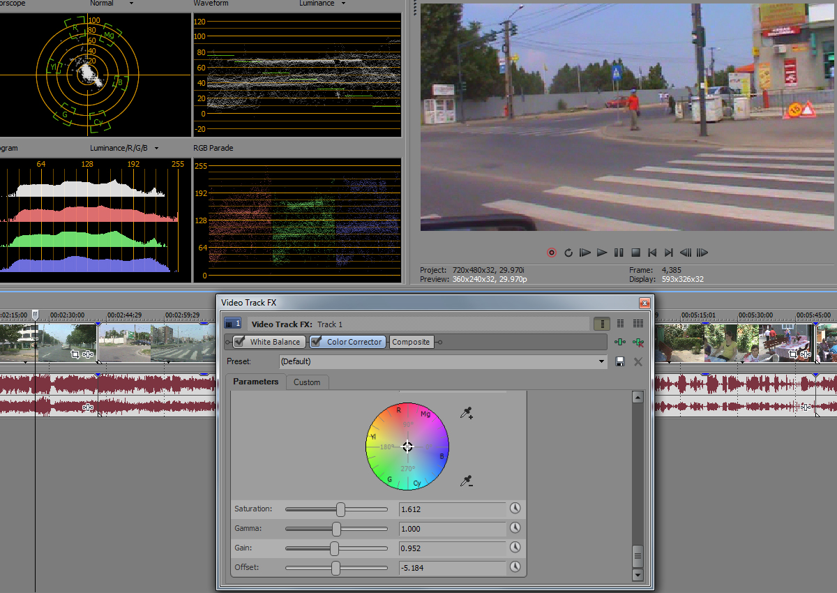

    1.612

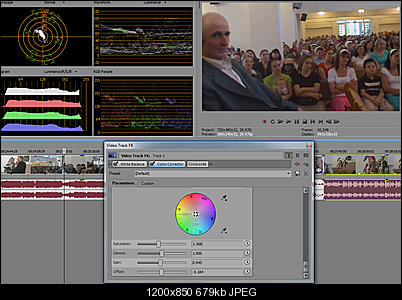

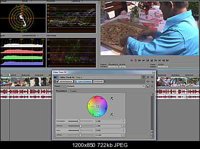

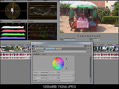

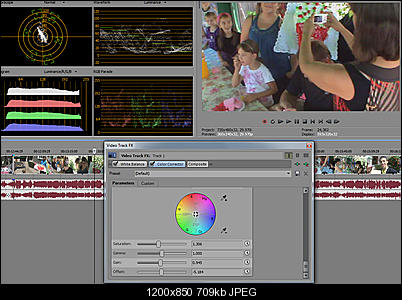

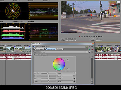

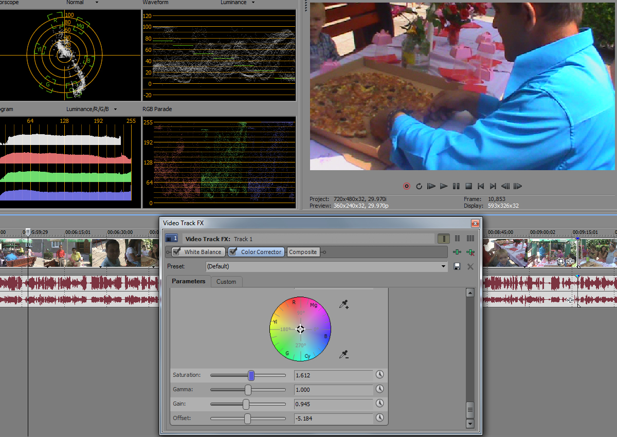

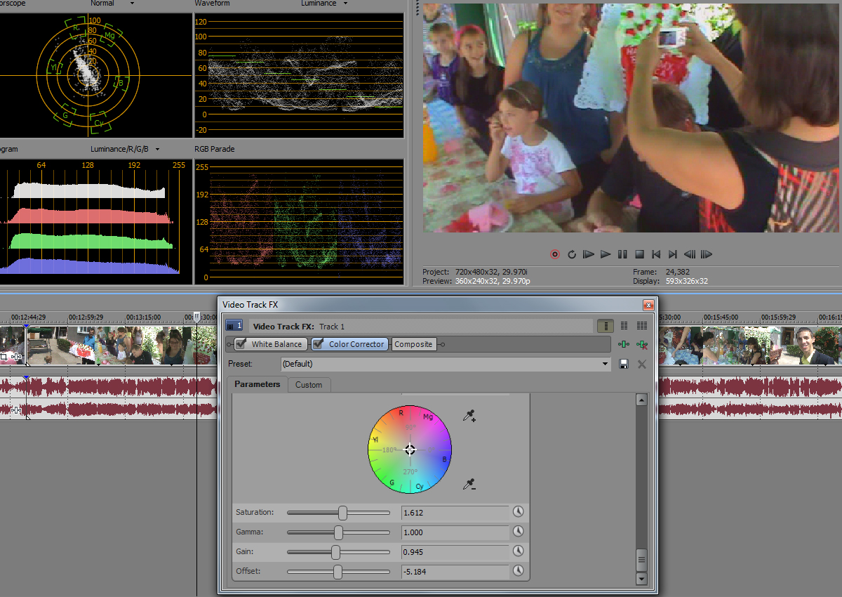

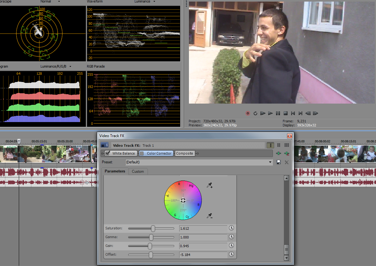

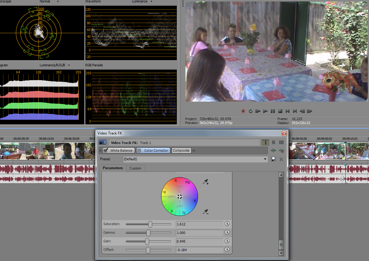

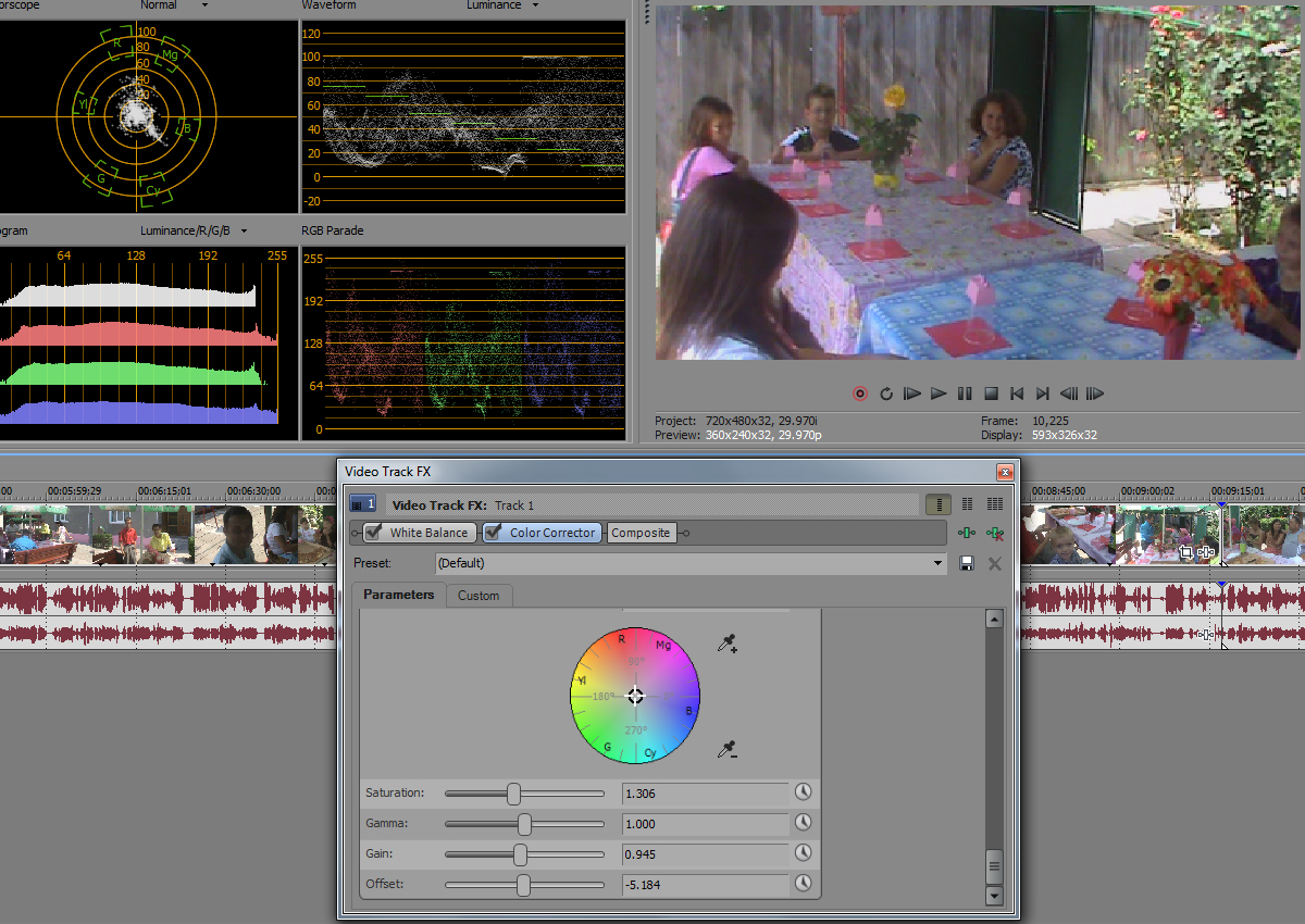

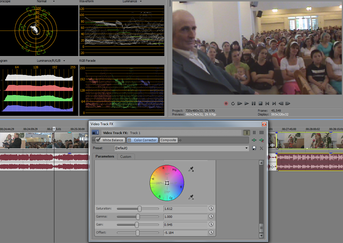

    Now let's get to the action shots, people, etc. Why I think my "more" makes the most sense and looks the most real in regards to how the world looks, to an extent, if that makes any sense.
    Regular
    1.306

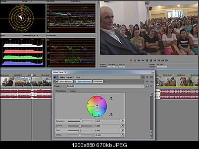

    1.612

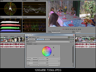

    1.306

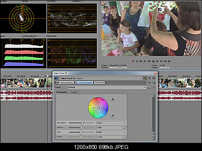

    1.612

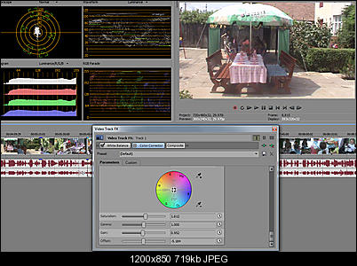

    1.612

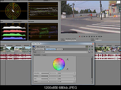

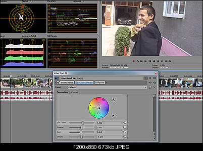

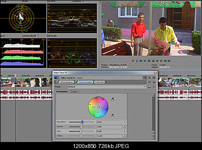

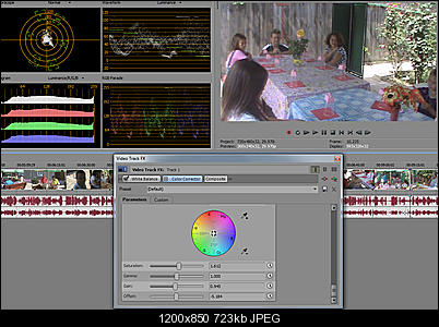

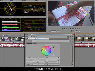

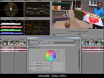

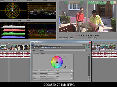

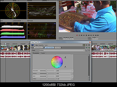

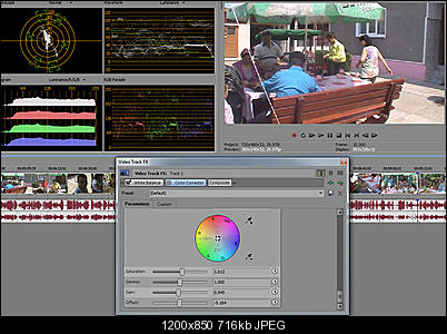

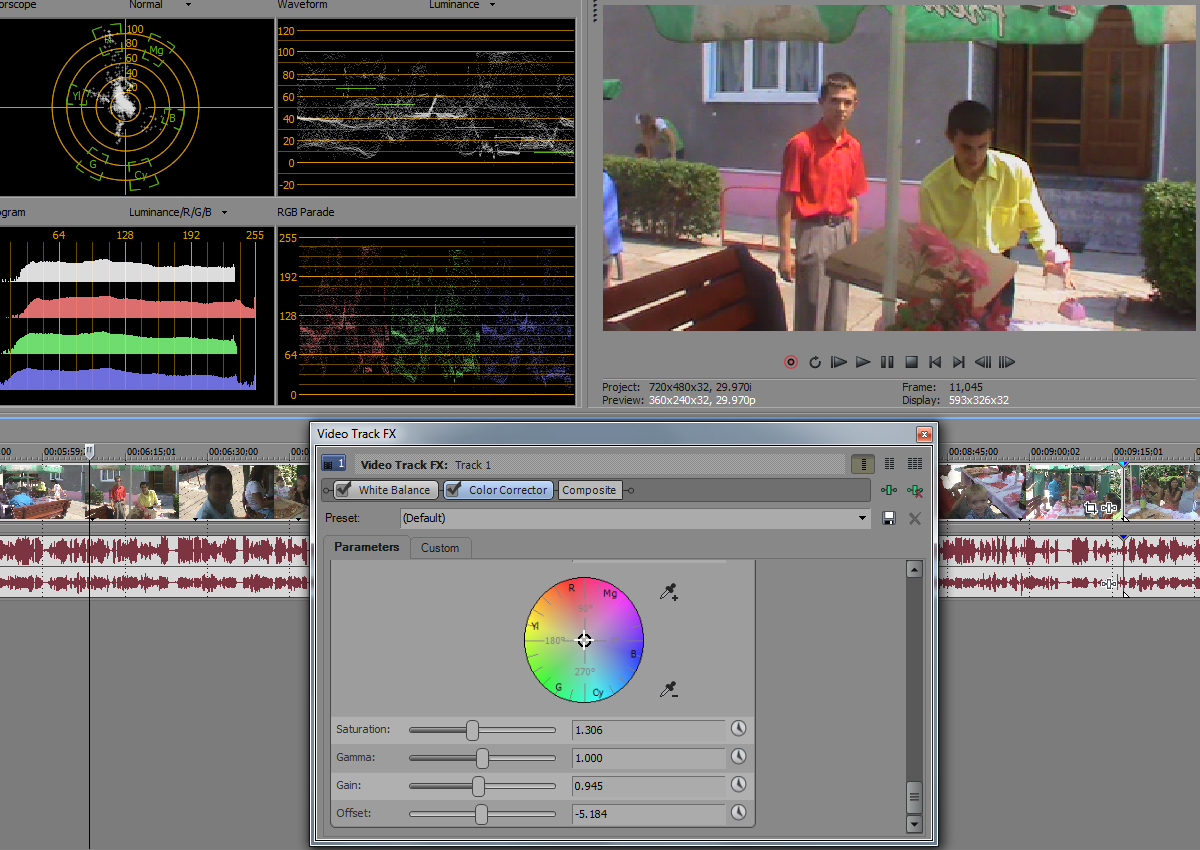

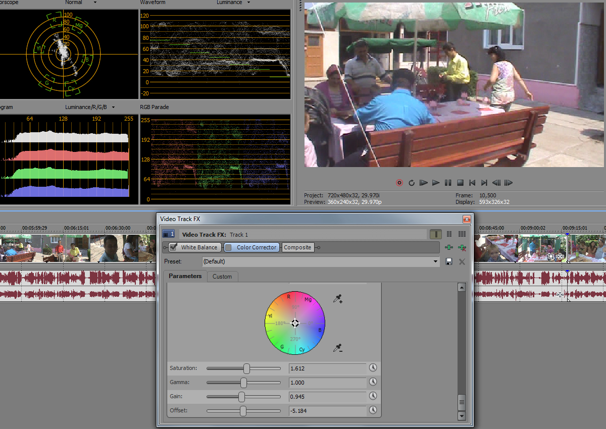

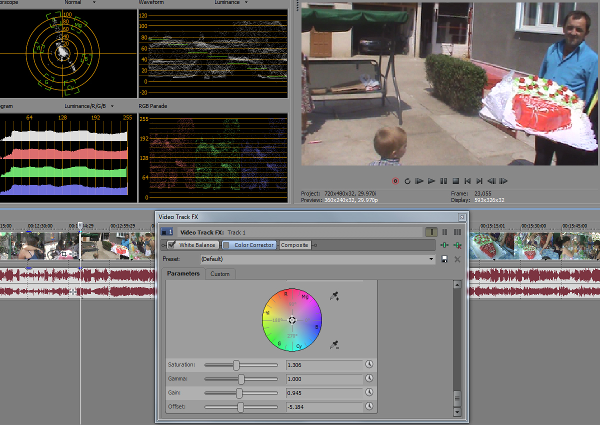

    Now here's where things get tricky, if you've been looking at the vectorscope, it's been A-OK up until this point from what I know about it. The majority of the dots are supposed to stay inside the circle, right? Well, now when I get to 2 certain points in the video, a blue shirt and a red shirt/cake, the dots fly off the vectorscope. Now the problem here is that I don't know if I should worry about this because I'm pretty sure it's only happening because those 2 things are shining bright because of the sun...because at no other points in the project do the dots go past the circle other than these moments when the sun shines upon these two things. So, should I compensate and lower the saturation of the whole project because of these small seconds of moments, is that what you're supposed to do? Can you target one color like so and lower only it's saturation (if that's a normal practice)? Has it overall been too saturated up to this point and these 2 moments are simply highlighting the truth? These are the things that I don't know as a novice.
    Note the vectorscopes:
    Regular
    1.306
    1.612

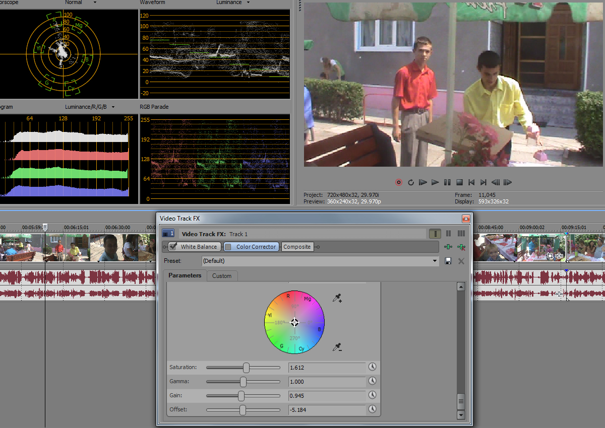

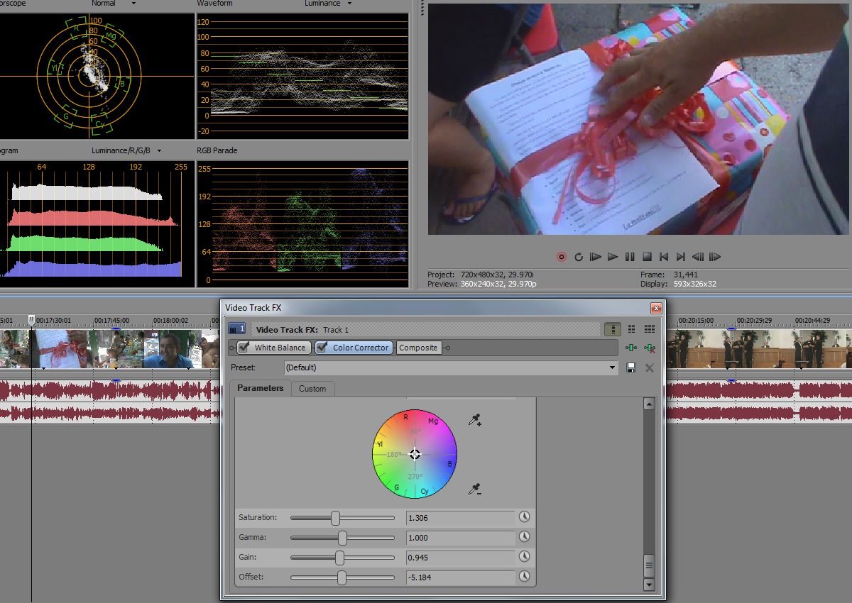

    1.612 (yes, in this instance I do notice how much detail left the red shirt, but other than that I still feel that this is the best option overall...)

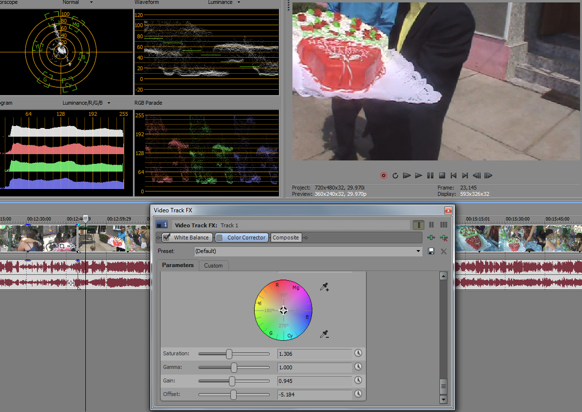

    1.306 (once again, I believe this is better than the next one since the next one absolutely crushes the cake details, but even with THIS one the dots fly off the vectorscope, if I can't even choose this setting according to the vectorscope...then what can I do?)

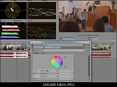

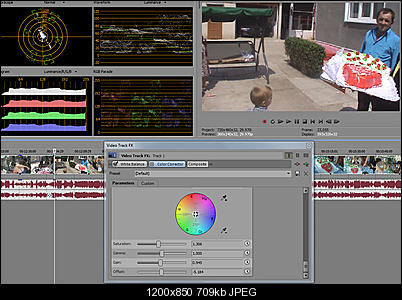

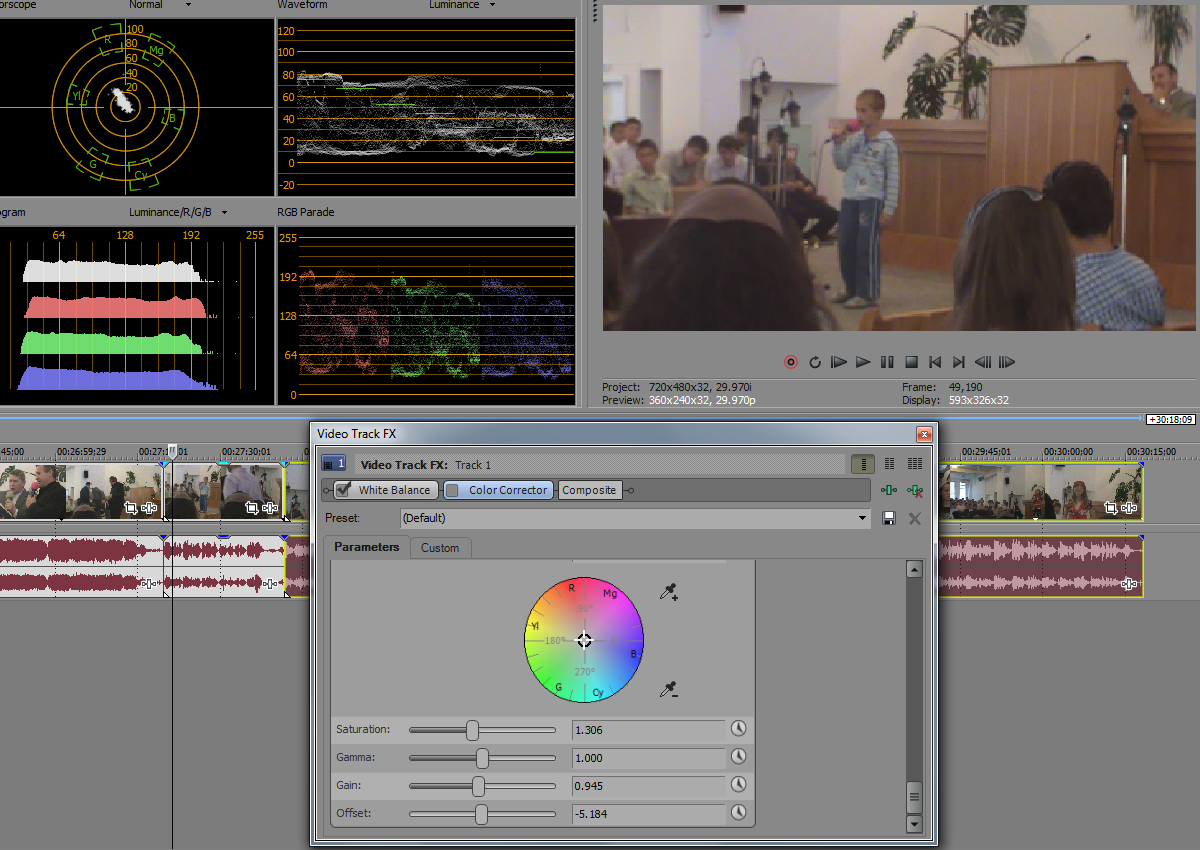

    Once again, once we get out of that bright sunlight, all the dots stay nice and clean inside of the scope.
    Regular
    1.306

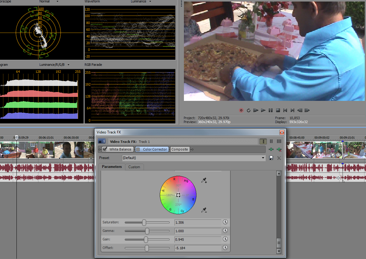

    1.306

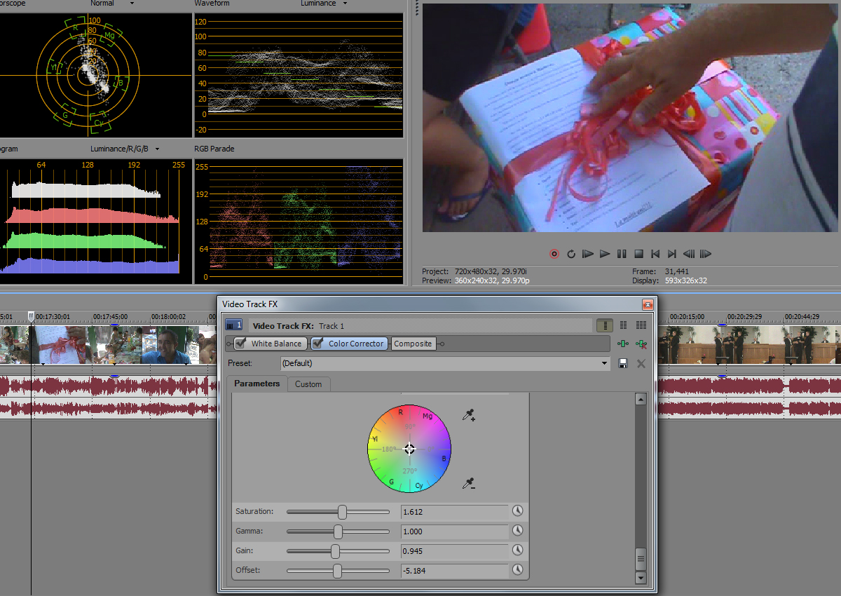

    1.612

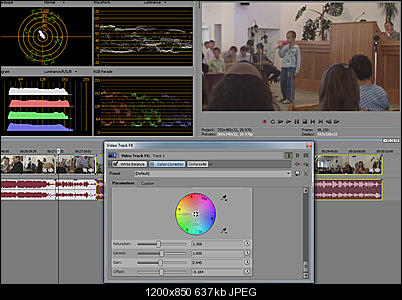

    For the heck of it, a bit of later on of the same day in the same project video, using the same settings (which is what I will be doing rather than changing individual settings for each small clip):

    1.306

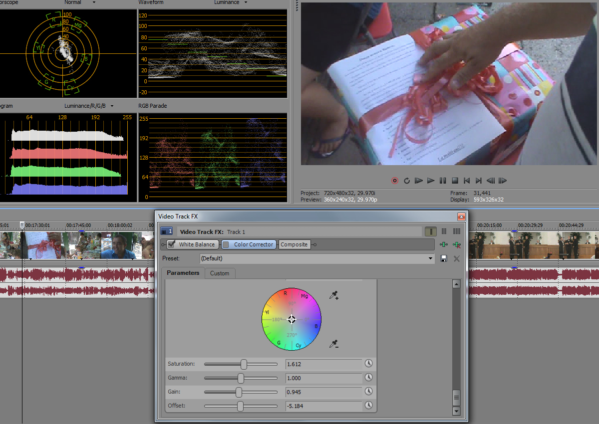

    1.612

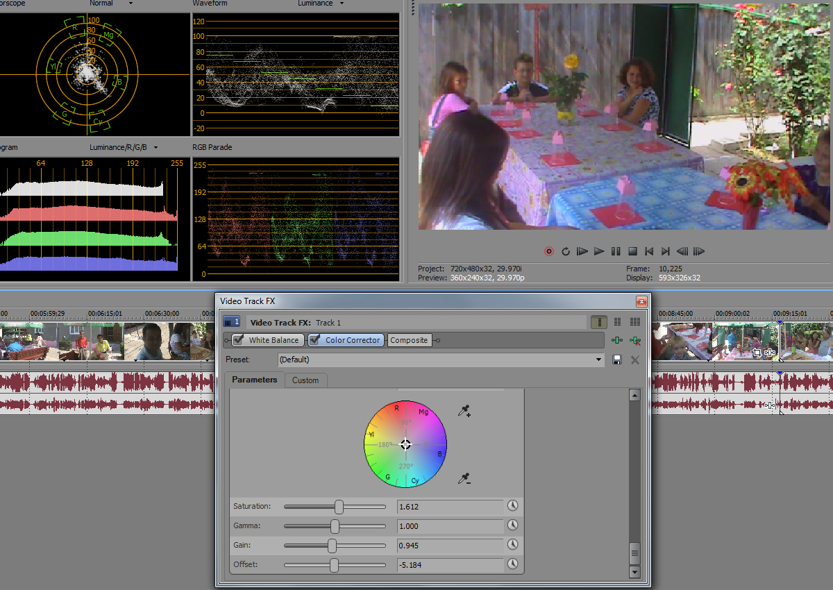

    So now, phew. 46 images. Hopefully that's enough visual information for you experts out there, if you need to see something else, footage, a different number setting example, let me know. But I think it should suffice.
    Basically, which one would you pick? Is there a general number you never go past as a rule of thumb for videos like this (or camcorder footage), like 1.2, 1.3, 0.5, etc.?
    Is my 1.612 too much in your opinion?
    Is it only too much in those few instances where the sun shines brightly on those few things; could you reduce it in those few objects somehow while keeping the rest 1.612, would you even attempt that or is that too high regardless?
    Would you do anything differently, another filter, another setting?
    In which do the people look more naturally skin toned? In which does the world look more natural?
    Is it okay to sometimes go outside the vectorscope in your clip, either a lot only for a couple seconds in the total project or a little dot here and there occasionally? Or is it ALWAYS a big no?
    All of those questions and whatever else that could go into this equation, I want to hear your input, your methods, your expertise.
    If you got through all of that, thank you, and I hope to get a response from you.
  2. It's not ok to exceed vectorscope limits.
    Waveform should almost always go from 0 to 100 (unless you know you are using 7.5 IRE, which does not appear to be the case here.) Judging by your RGB Parade, this is where your main issues are. Your contrast is too compressed in every image posted. Your colors will appear more saturated if your black levels are correct.
    Once you meet the "legal" requirements, the rest is personal aesthetics.

  4. Every one of your adjustments looks worse than the original. I recommend not adjusting saturation unless you are trying to achieve a special effect. One exception to this is using the Vegas "Secondary Color Corrector." It can let you adjust a specific color range, and only the part of that range which is too saturated. I've seldom seen under-saturated colors. The over-saturated problem is quite common when capturing NTSC video because of the way red is stored. It often tends to bloom, and one correction that can help is to select just that color and then slightly reduce the saturation.
    Increasing saturation almost always looks fake. Also, as you have found, even a small correction can lead to out-of-gamut results.
